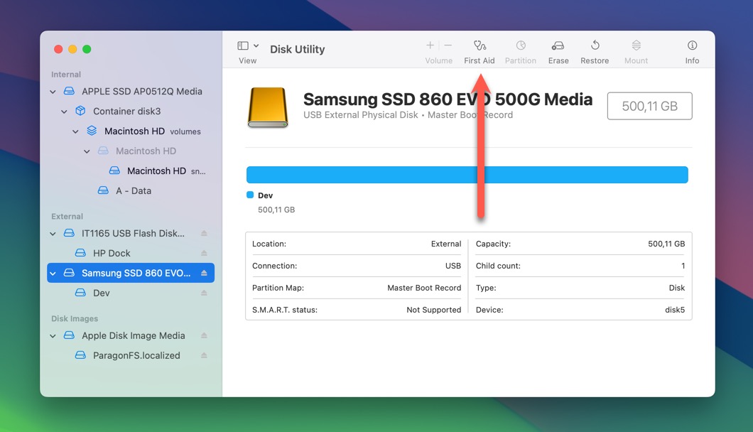

Method 4:Use First Aid on the External Hard Drive
The First Aid tool helps more than your computer’s internal drive. It can also see the hard drive on Mac connections from external sources.
If you aren’t getting a proper mount with your external HDD or SSD storage, activate First Aid to see if it can help.
  1. Navigate to your System Settings through the Apple menu screen.
  2. Select the Disk Utility option.
  3. Highlight the external hard drive and choose “First Aid“.
  4. You’ll get asked if you want to run it on the media. Click the “Run” button.first aid disk utility external hard drive
You can also try to force the connection to your Mac by selecting your external hard drive in Disk Utility and clicking the “Mount” option (located in the same toolbar as the “First Aid” option).

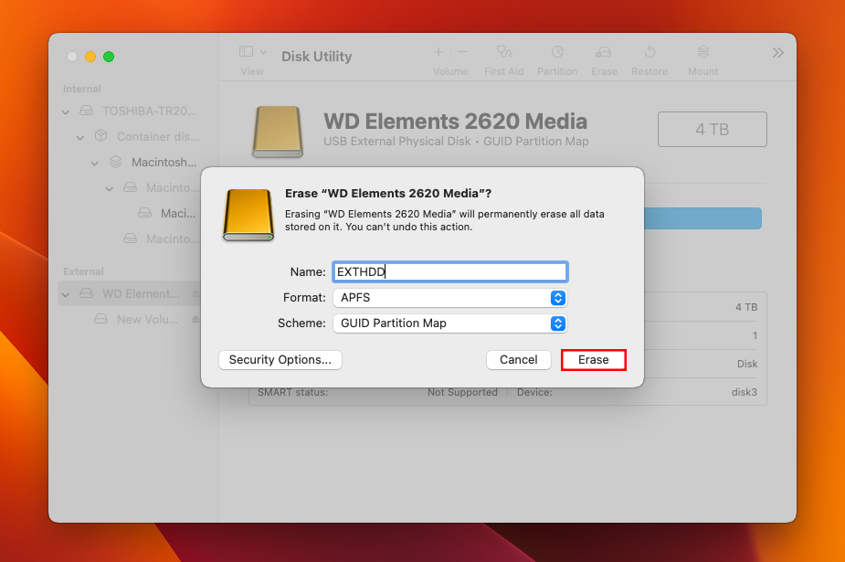

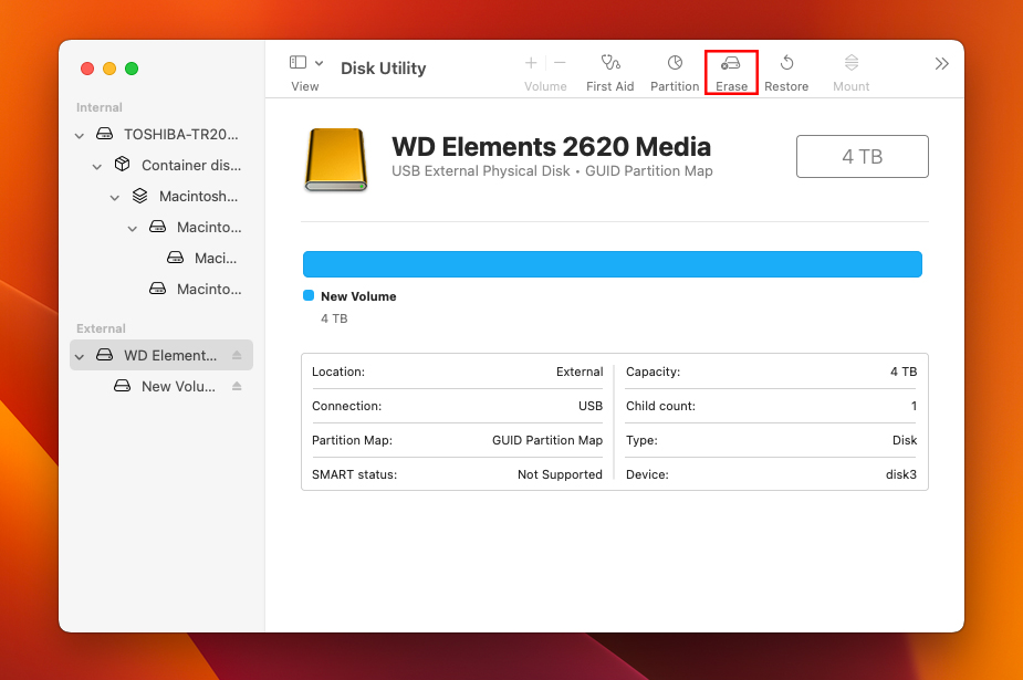

To format a drive in macOS, you need to:
  1. Launch Disk Utility. You can find it in the Utilities folder within Applications.
  2. Once Disk Utility is open, you’ll see a list of drives on the left. Find your external hard drive in this list and select it.
  3. With the drive selected, click the “Erase” button at the top of the Disk Utility window.disk utility erase
  4. Now, you’ll see some options for formatting your drive. For the “Format” option, choose APFS (Apple File System) if your drive will only be used with Macs running macOS High Sierra or later. If you need it to work with Windows PCs, choose ExFAT instead.
  5. You can also rename your drive in the “Name” field. This is optional but can help you identify the drive later.
  6. Once you’re ready, click on “Erase” at the bottom. Disk Utility will now reformat your drive, making it fresh and readable by your Mac.disk utility erase ext hdd

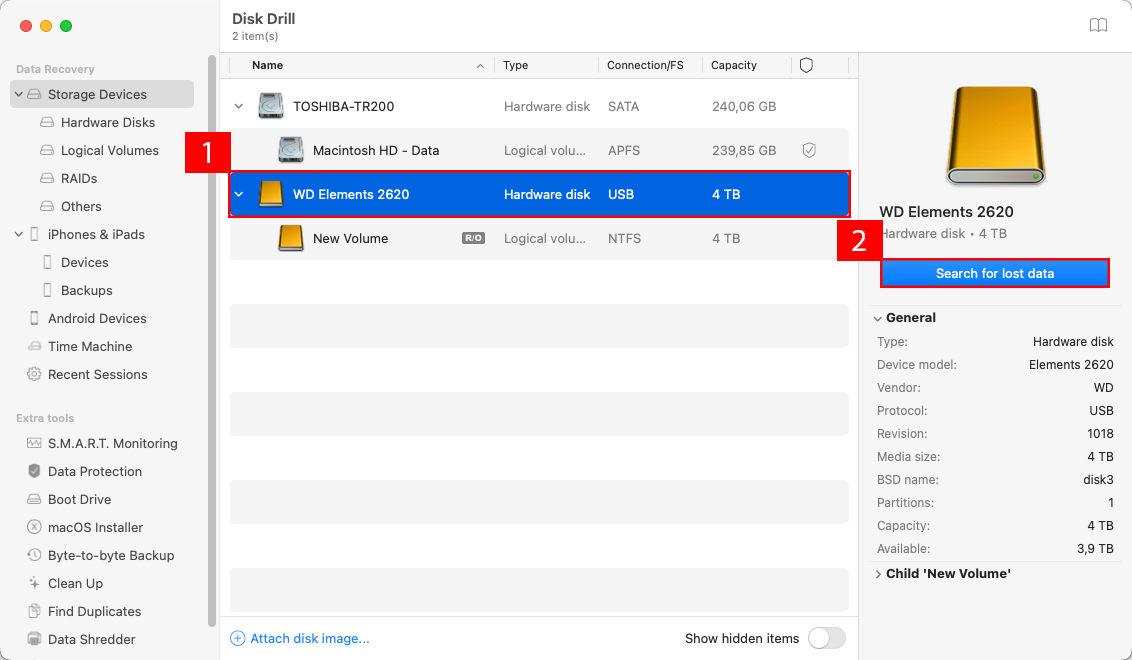

  1. Download and install the Mac version of Disk Drill on your computer.
  2. Choose the external hard drive you want the tool to analyze and click the “Search for lost data” button to initiate the process.

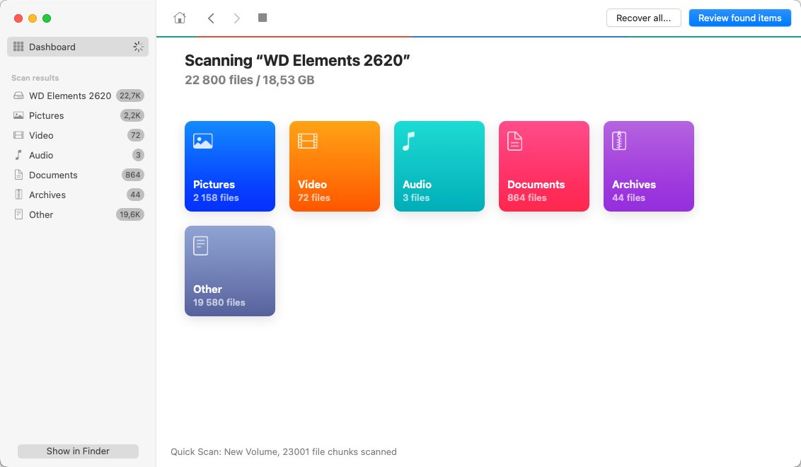

    start scan with disk drill
  3. The software will scan your external hard drive. The process may take a while depending on the size and speed of your external hard drive, but you don’t have to wait until it finishes to see the results. You can click the Review found items button to see recoverable files with scanning continuing in the background.

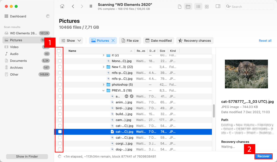

  4. Next, you need to select all missing files. Disk Drill’s preview feature and file type filters can help you quickly find all important data. Once that’s done, you can click “Recover“.select files to recover

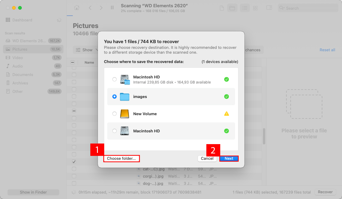

  5. Finally, specify the recovery location (you should never save recovered files to the same external drive safely) to keep your data safe and click “Next“.recover files
