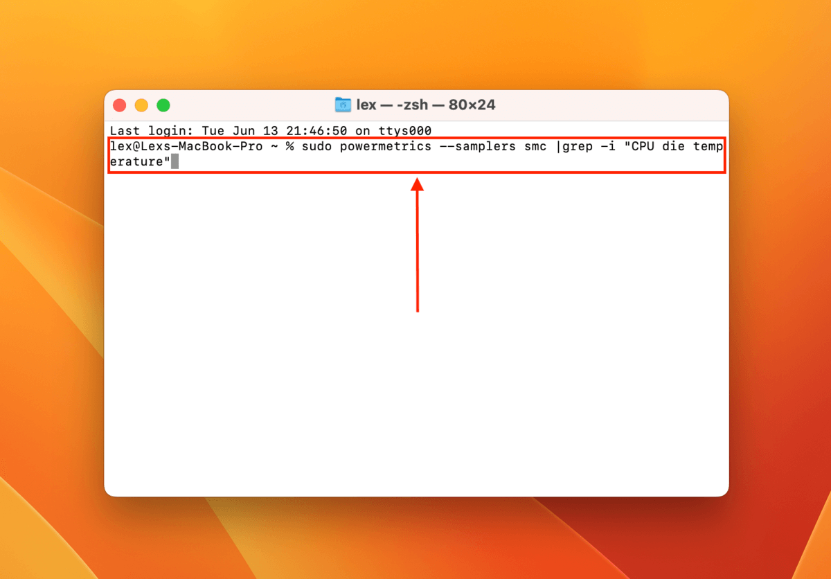

To confirm if this is indeed your Mac’s primary issue, you can check your temperature using a simple command in the Terminal app.
Unfortunately, this tool isn’t available for M1 Macs and newer models. Instead, we recommend a reliable third-party software like TG Pro.

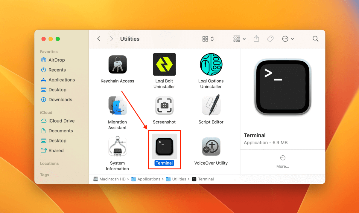

To check your Mac’s temperature using Terminal:
Step 1. Launch the Terminal app (Finder > Applications > Utilities).
Terminal app in Finder
Step 2. Type the following command and hit Return:
sudo powermetrics –samplers smc |grep -i “CPU die temperature”
Terminal app for CPU temperature
Your Mac’s temperature should NOT be over 90℃. If your Mac gets this hot even if you aren’t using it in a humid environment, you aren’t running too many apps, and it has sufficient airflow, try Method 1. If that doesn’t work, you’ll have to bring your Mac to Apple for service.

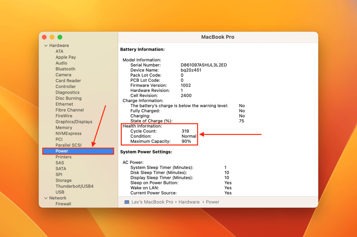

Method 5: Check your Battery Health
If your Mac suddenly turns off at a certain battery percentage, it’s probably nearing the end of its life. All batteries have a finite number of charge cycles. For old machines, it’s around 300. For newer machines, it’s 1,000+.
Before heading to the Apple store for a replacement, you can check your Mac’s battery health yourself.
To check your battery health on Mac:
Step 1. Open the Apple menu. Then, hold the Option key to make System Information appear in the dropdown menu. Click it.
System Information option in Apple Menu
Step 2. In the left sidebar under Hardware, click Power. On the right, view Battery Information > Health Information.
Mac System Information window
Here, you’ll see the cycle count that we discussed earlier. Then, note its Condition (Normal and Good are preferable) and its Maximum Capacity. In my Mac’s case, a Maximum Capacity of 90% means that I can now only use 90% of my Mac’s original battery capacity.

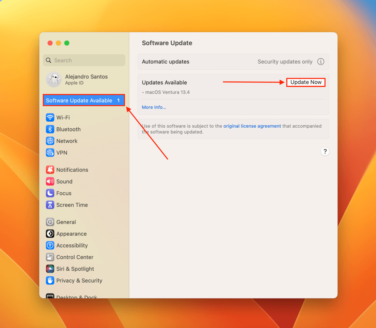

Method 7: Update or Reinstall MacOS
When macOS is outdated or corrupted, shutdowns can happen due to incompatibility, system bugs, instability, security vulnerabilities, and/or corrupted system files. Updating it may solve the issue.
To update macOS:

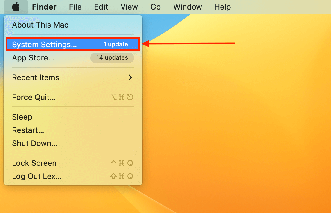

Step 1. Click the Apple menu > System Settings…
System Settings option in the Apple menu
Step 2. Click Software Update or Software Update Available. Mac will begin downloading any available updates. If it finds any, click Update Now (or Install for minor updates) and accept the License Agreement. Wait for the update to complete and keep your Mac plugged in during the process!
macOS update in System Settings

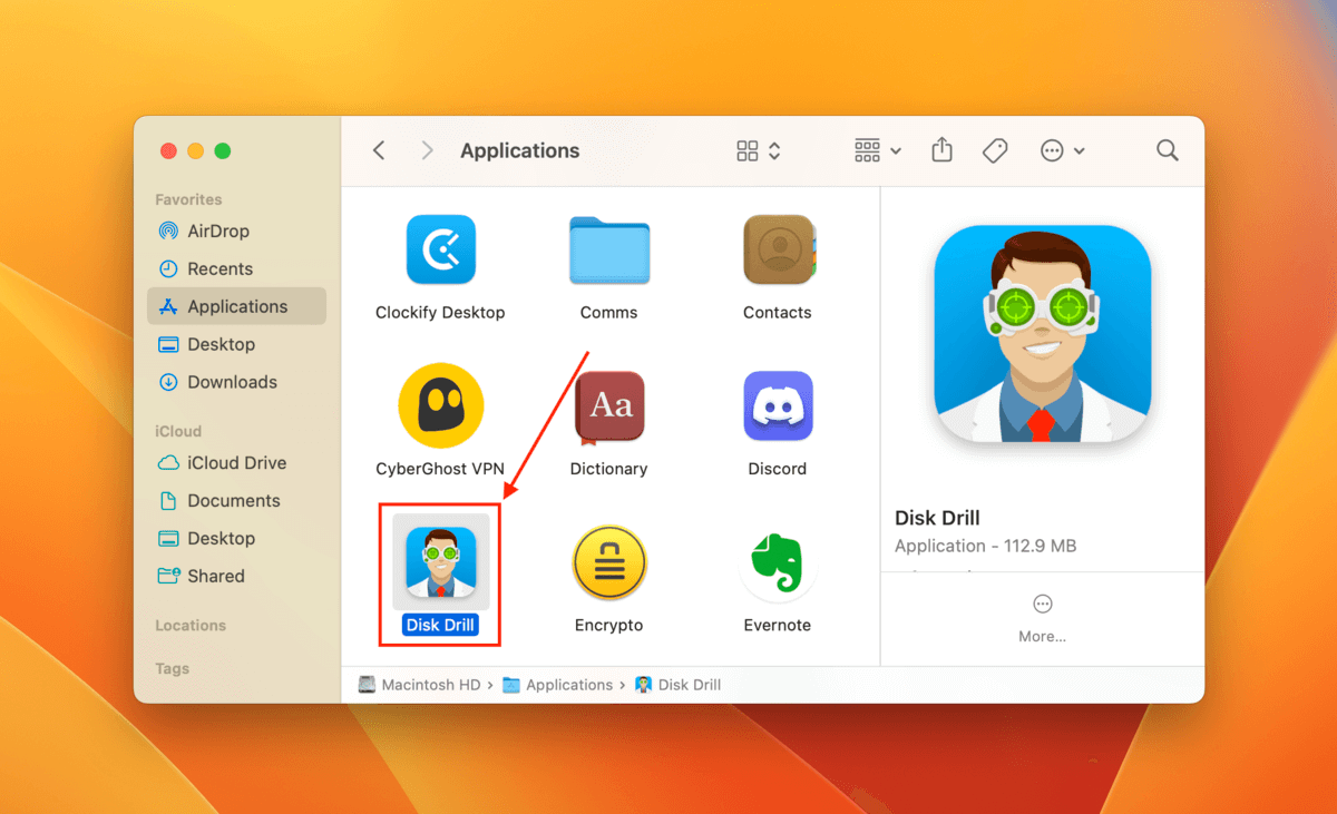

For this article, we’ll be using a tool called Disk Drill. It’s really powerful but easy to use for beginners, and it has excellent support for Mac file systems (HFS+, APFS) and file types (400+ file types and counting). Below, we prepared a step-by-step guide you can follow along with.
To recover deleted data on your Mac using Disk Drill:

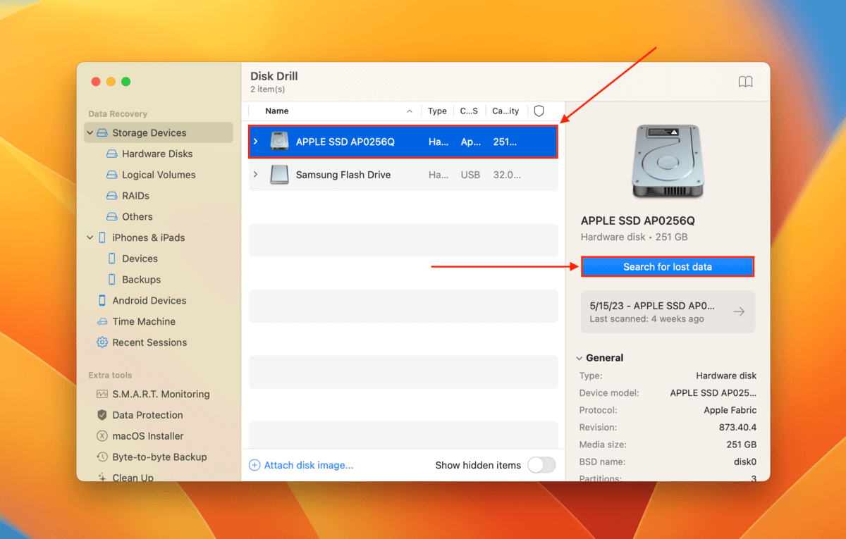

Step 2. Connect a storage device to your Mac, ensuring it has enough space for the data you want to restore (you shouldn’t save recovered data to the same drive you’re recovering). Launch the Disk Drill app (Finder > Applications).
Step 3. Select your system drive (usually labeled “APPLE SSD”) and click Search for lost data.
Disk Drill drive list

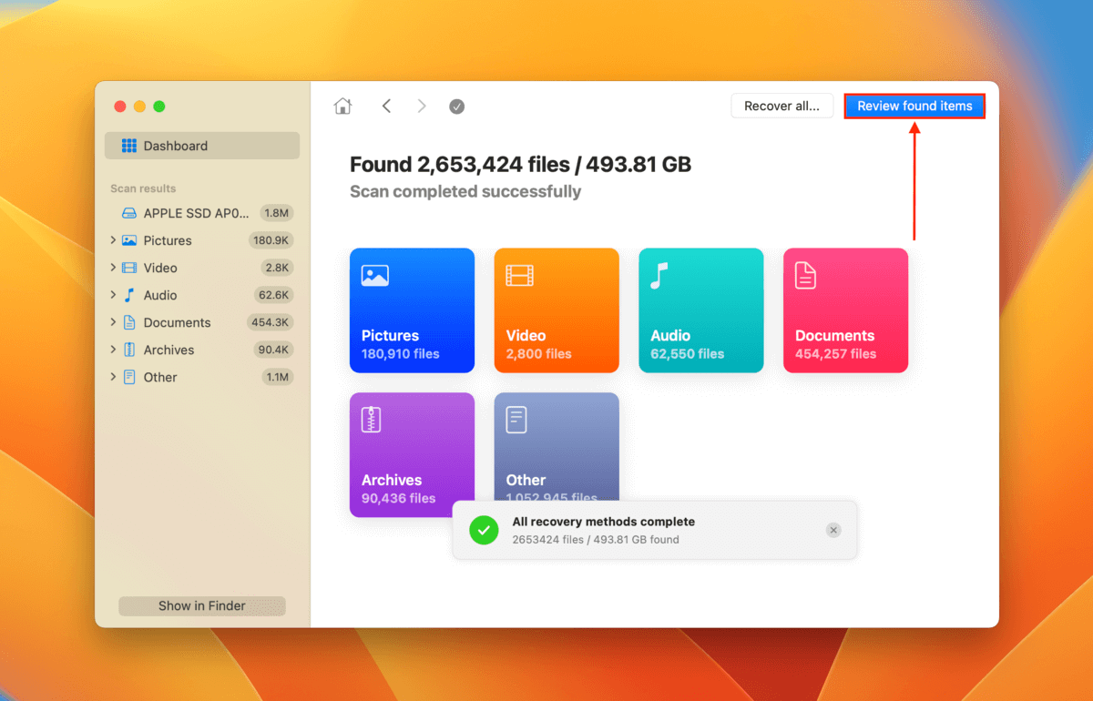

Step 4. Once Disk Drill finishes scanning your drive, click Review found items.
Disk Drill Review scan results button

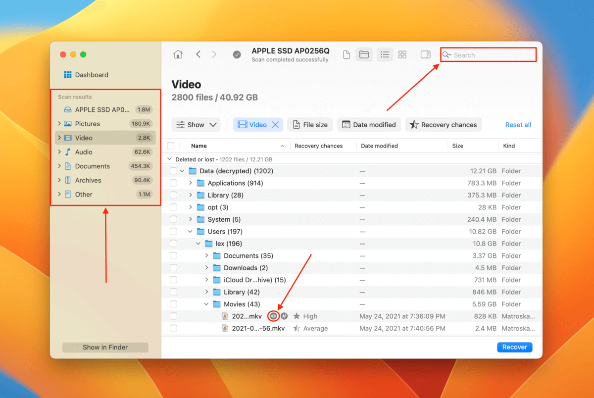

Step 5. Expand the Deleted or lost and/or the Reconstructed tabs to browse files that were deleted or unsaved (due to the shutdowns or reinstalling macOS). You can filter scan results by file type using the sidebar or use the search tool to locate a specific file. You can also preview any file by hovering your mouse pointer beside it and clicking the eye button that appears.
Disk Drill Filter, Search, and Preview tools

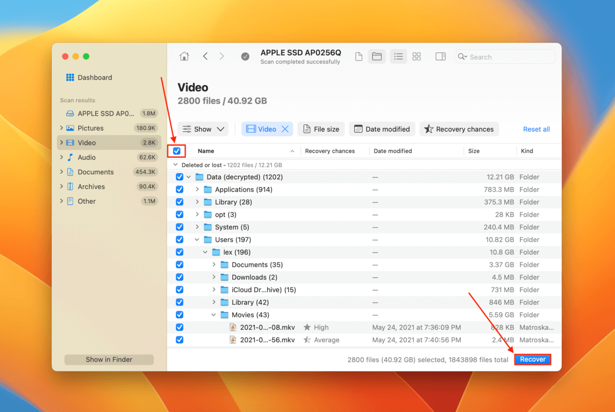

Step 6. Mark the boxes beside the files you want to recover. If you want to restore all the files Disk Drill found, mark the box in the column header (beside Name). Then, click Recover.
Disk Drill file selection

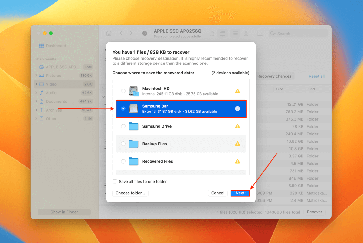

Step 7. Choose a save location on the storage device you connected in Step 2. Then, click Next to proceed with recovery.
Disk Drill recovery folder selection
