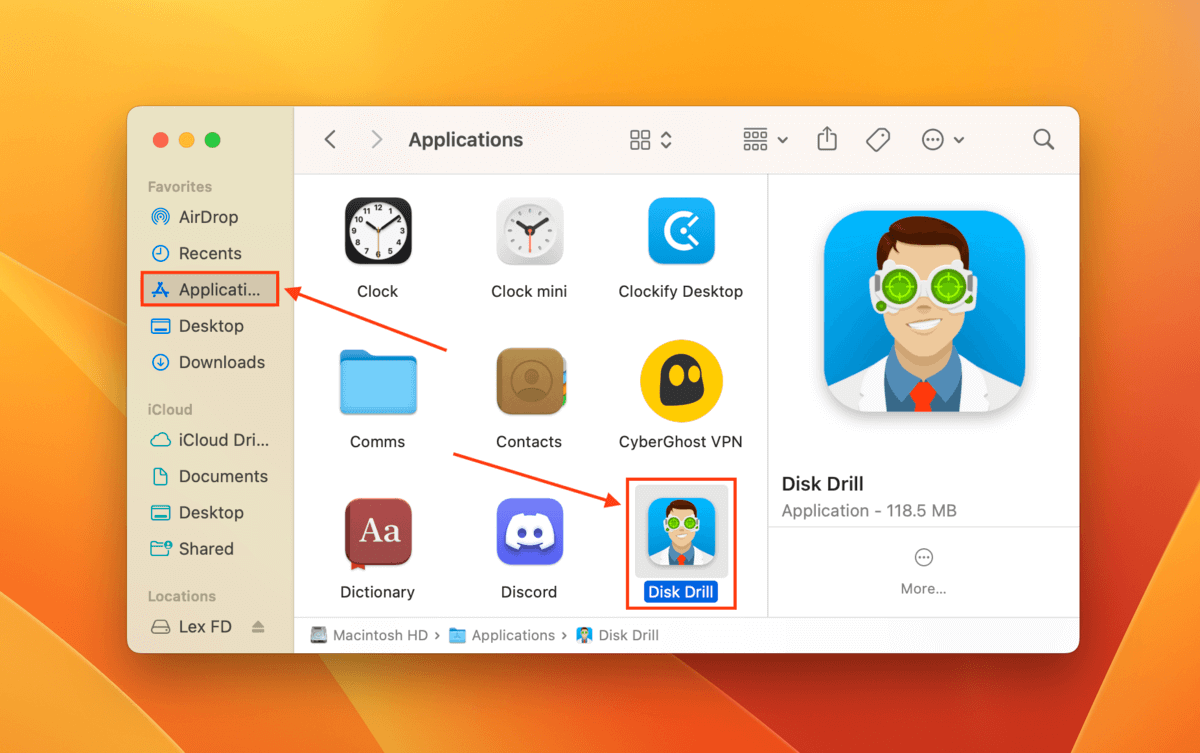

Tip: If problems were found with the partition map which might prevent booting, you can operate Disk Drill from recovery mode. Once in recovery mode, launch the Terminal app from the Utilities menu and execute the following command before proceeding with Step 3:
Disk Drill app in the Applications folder

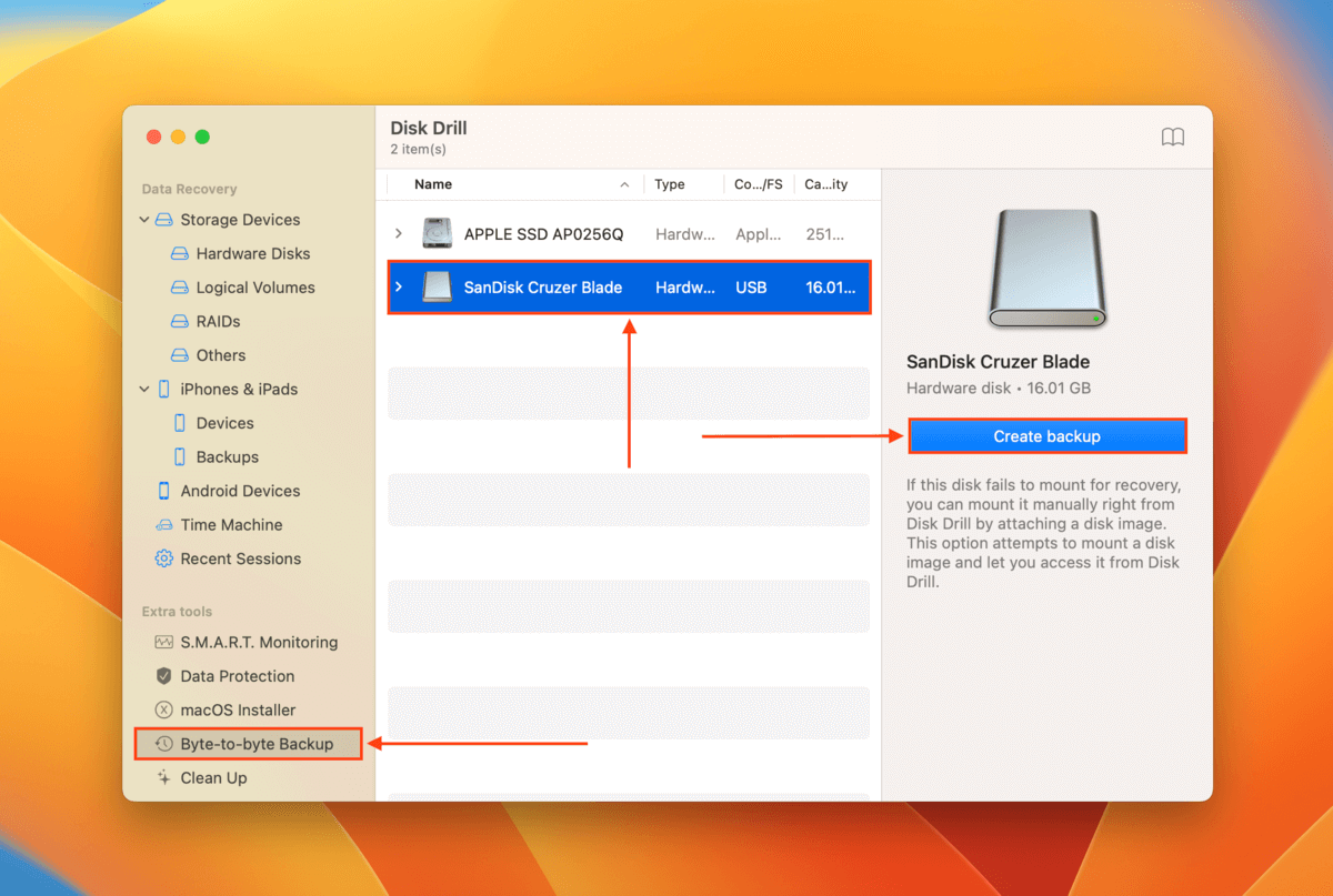

Step 3. On the left sidebar, click Byte-to-byte Backup. Then, select the faulty drive (if it’s your system drive, select APPLE SSD) and click Create backup.
Disk Drill Byte-to-byte backup menu

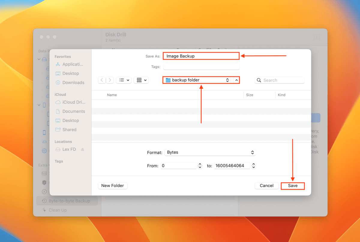

Step 4. Select a location where Disk Drill will save the backup file. We recommend saving it to a drive other than the one you are experiencing errors with. Then, click Save.
Disk Drill backup creation dialogue

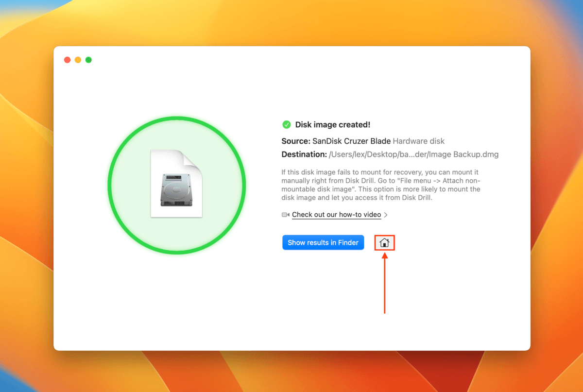

Step 5. Once Disk Drill is done creating the backup, click the Home button.
Disk Drill backup completion screen

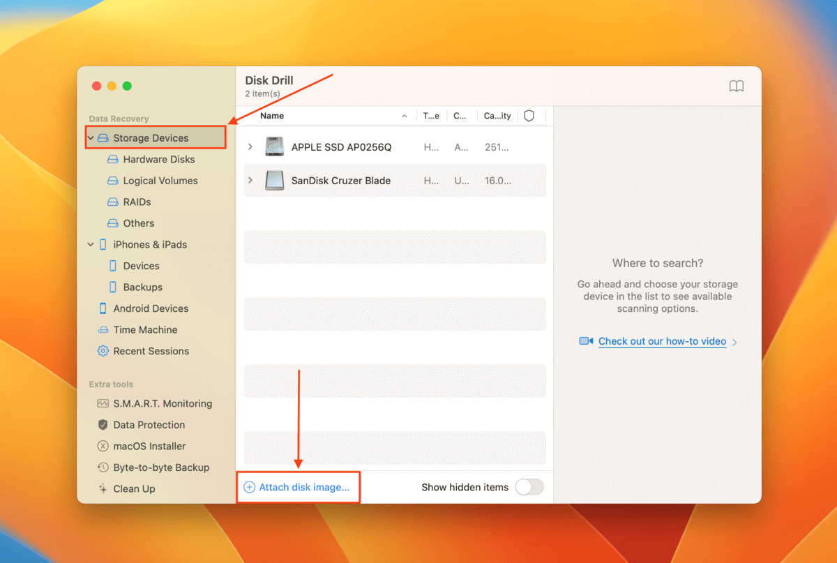

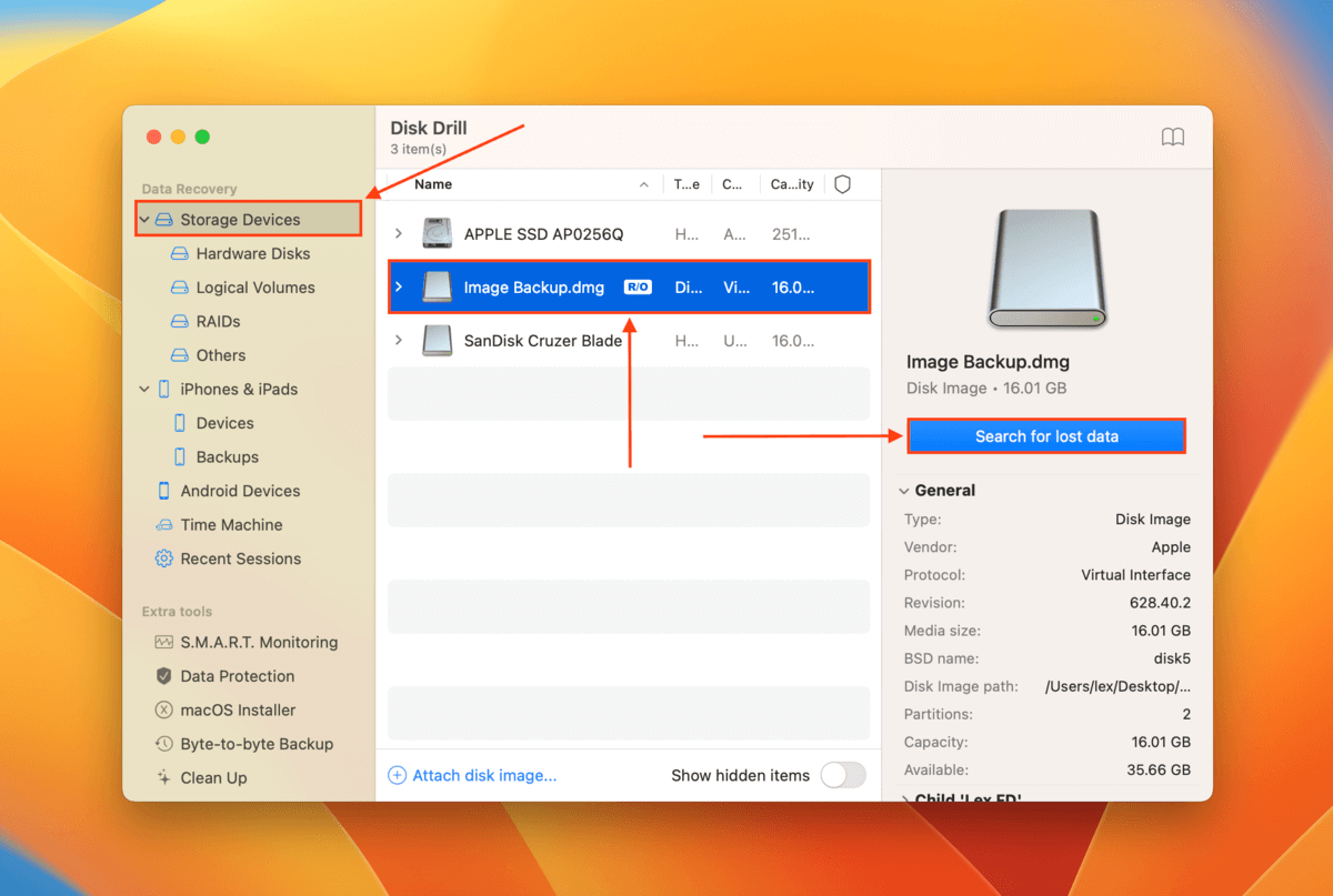

Step 6. On the left sidebar, click Storage devices. Then, at the bottom of the window, click Attach disk image.
Disk Drill disk image attachment button

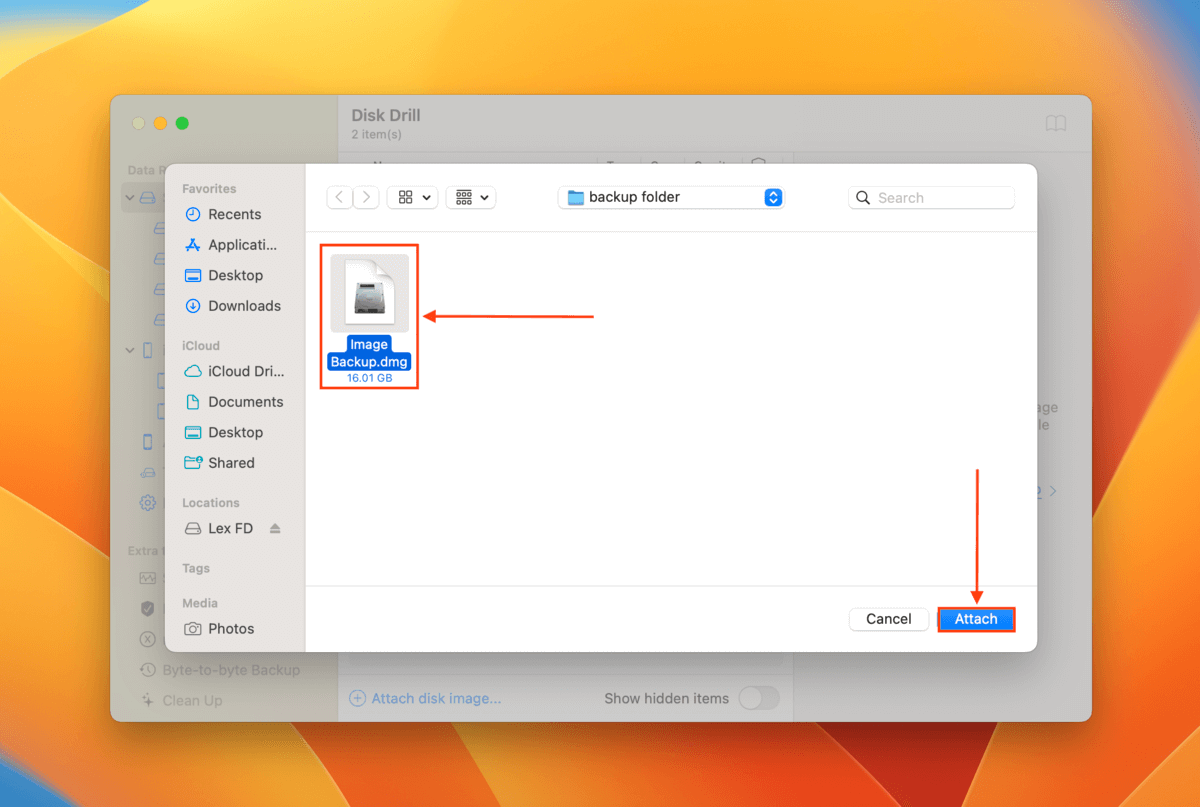

Step 7. Locate and select the image backup we created in step 4 and click Attach.
Disk Drill disk image attachment dialogue window
Step 8. Select the image backup we just attached and click Search for lost data.
Disk Drill initial screen

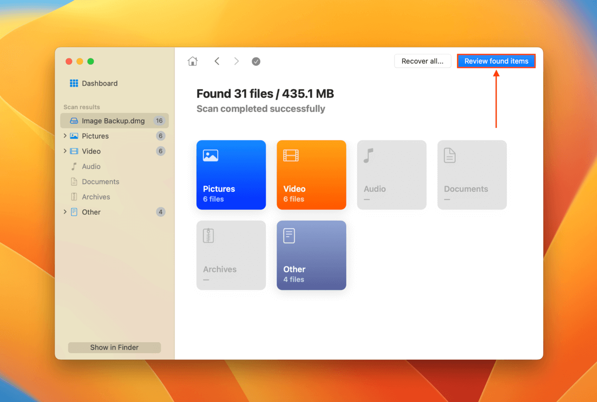

Step 9. Once Disk Drill completes its scan, click Review found items.
Disk Drill scan completion screen

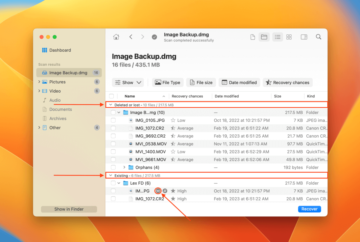

Step 10. Click the arrow beside Existing to expand the tab. These are all the files that were on the drive when you created the image backup. You may also check the Deleted or lost and Reconstructed tabs if you think your data may have been deleted due to corruption. You can also preview any file by hovering your mouse beside it and clicking the eye button that appears.
Disk Drill existing and deleted files

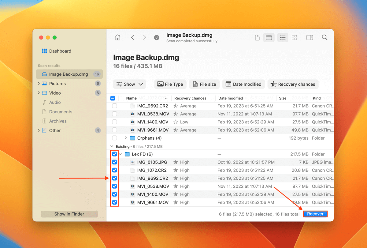

Step 11. Select the files/folders you want to restore using the boxes in the leftmost column. If you want to restore all the files Disk Drill found, select the box in the column header. Then, click Recover.
Disk Drill file selection

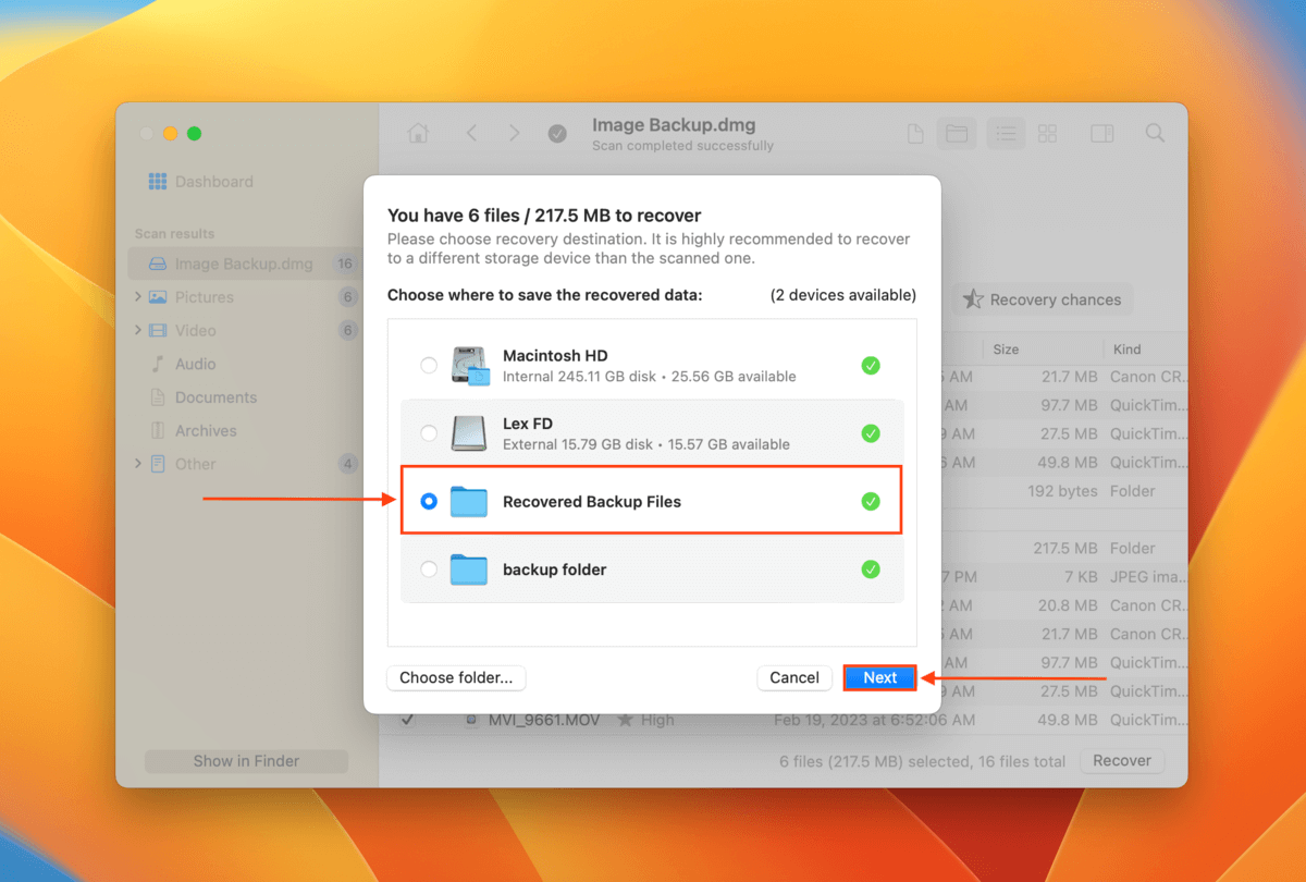

Step 12. In the dialogue box that appears, select a location where Disk Drill will save the restored files. Make sure you don’t save it to the faulty drive. Then, click Next to proceed with recovery.
Disk Drill data recovery dialogue window

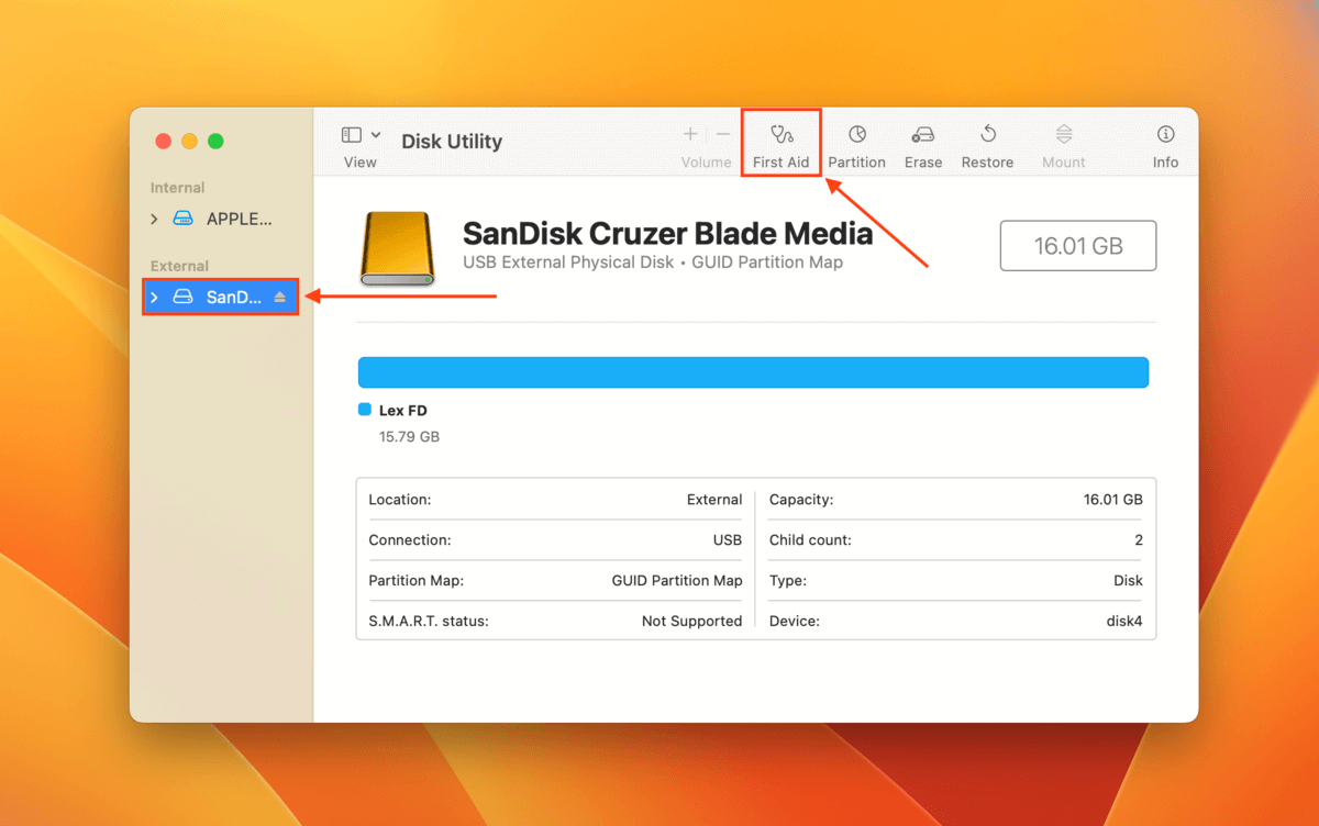

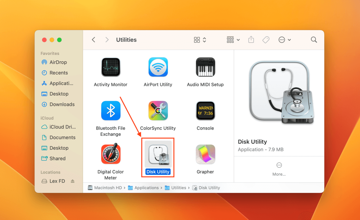

To use First Aid to repair your drive’s partition map, launch Disk Utility (Finder > Applications > Utilities).
Disk Utility app in Finder
Then, select your drive from the left sidebar and click the First Aid button at the top of the Disk Utility window. Confirm the process when prompted.
First Aid button in Disk Utility
Wait for the First Aid tool to complete its troubleshooting, then check if you can use your drive normally.

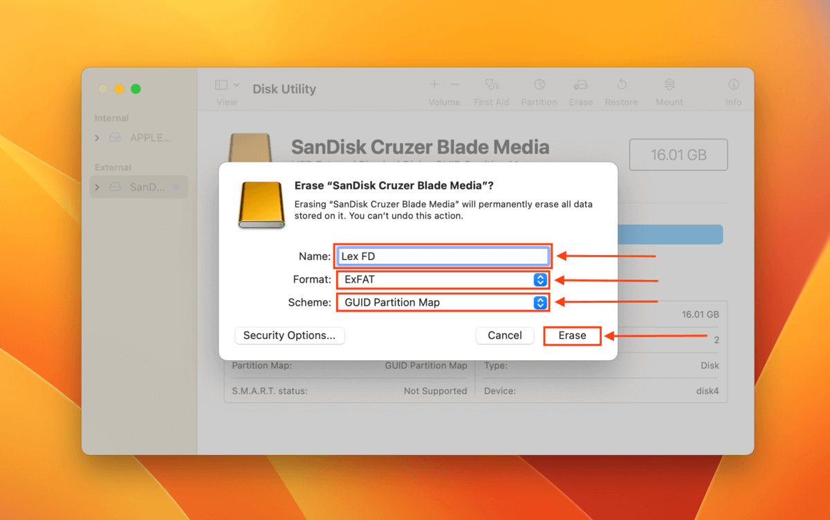

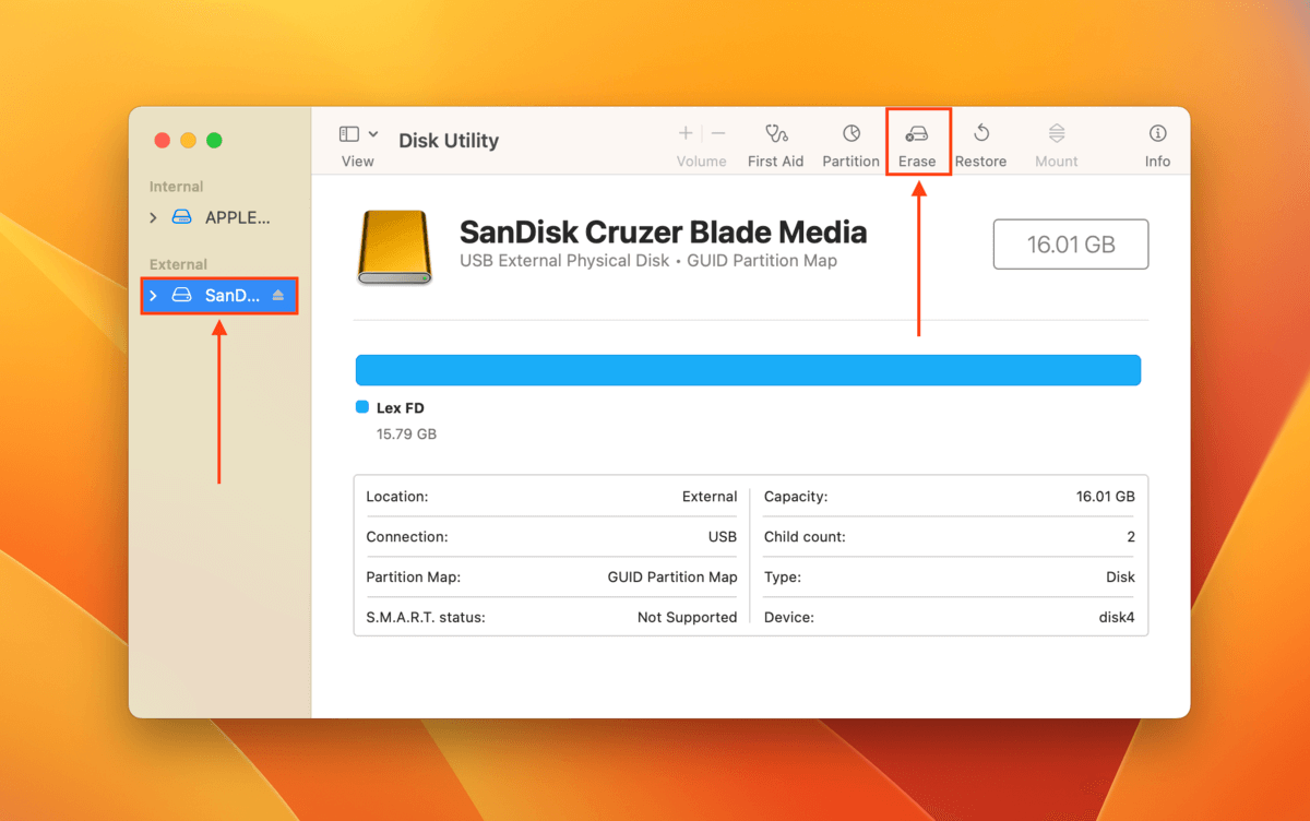

With Disk Utility open, select your drive from the left sidebar and click Erase at the top of the window.
Erase button in Disk Utility
Name your drive and select the file system and scheme you want. If you will be using the drive with Windows computers, we recommend the exFAT format and GUID Partition Map scheme. Once you’re satisfied, click Erase to proceed with the formatting process.
Erase dialogue in Disk Utility

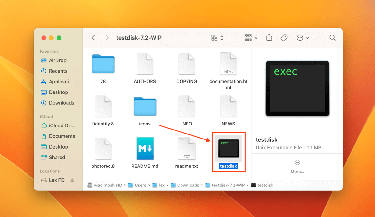

Step 1. Download and install TestDisk.
Step 2. With the faulty drive securely connected to your Mac, launch the Terminal app (Finder > Applications > Utilities).
TestDisk app in Finder

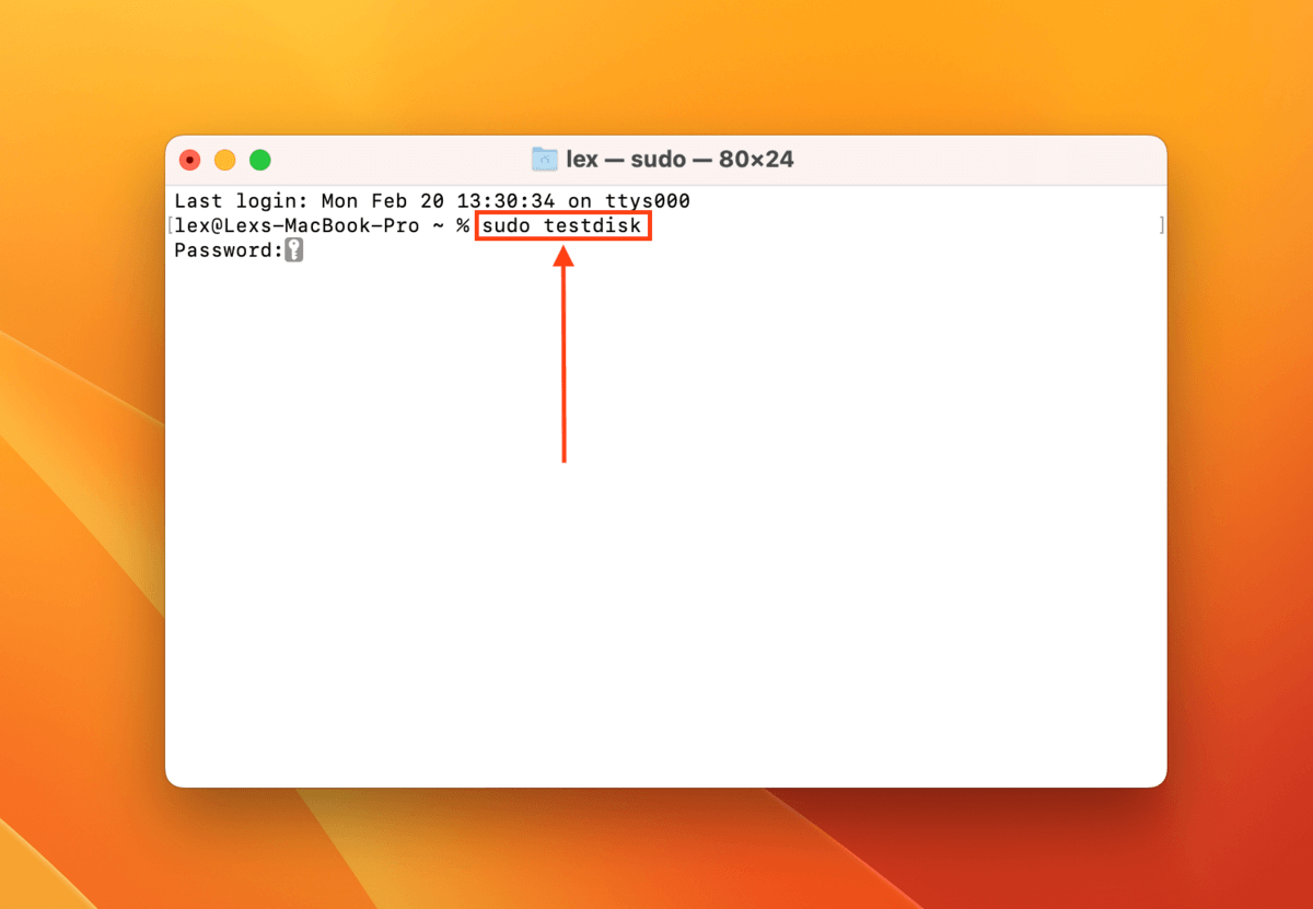

Step 3. Type the following command and hit Return:
sudo testdisk
Enter your password if prompted.
sudo TestDisk command in Terminal

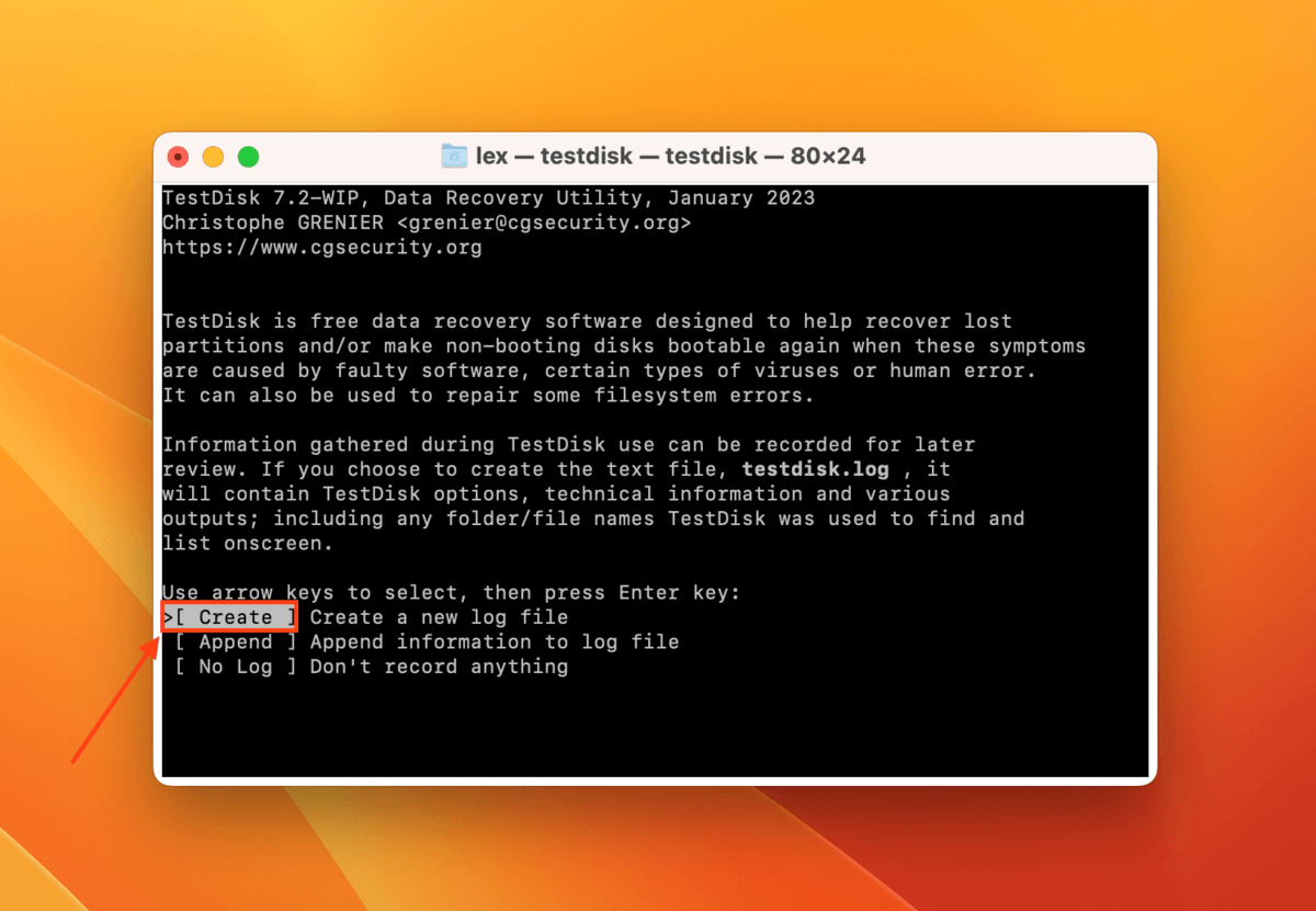

Step 4. Hit the Return key to select the Create option.
TestDisk initial screen

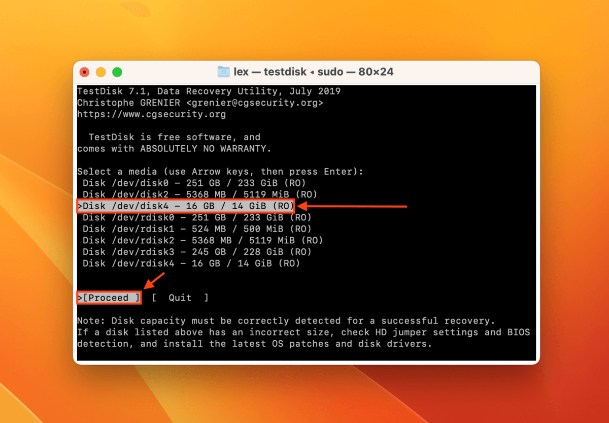

Step 5. Use the Up and Down arrow keys to highlight the faulty drive and hit Return to proceed.
Drive selection screen in TestDisk

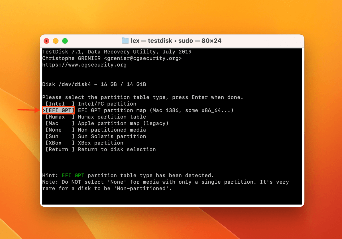

Step 6. Use the Up and Down arrow keys to highlight your drive’s partition table type. TestDisk is pretty good at detecting it automatically, so just hit Return on the default option if you aren’t sure.
Partition selection screen in TestDisk

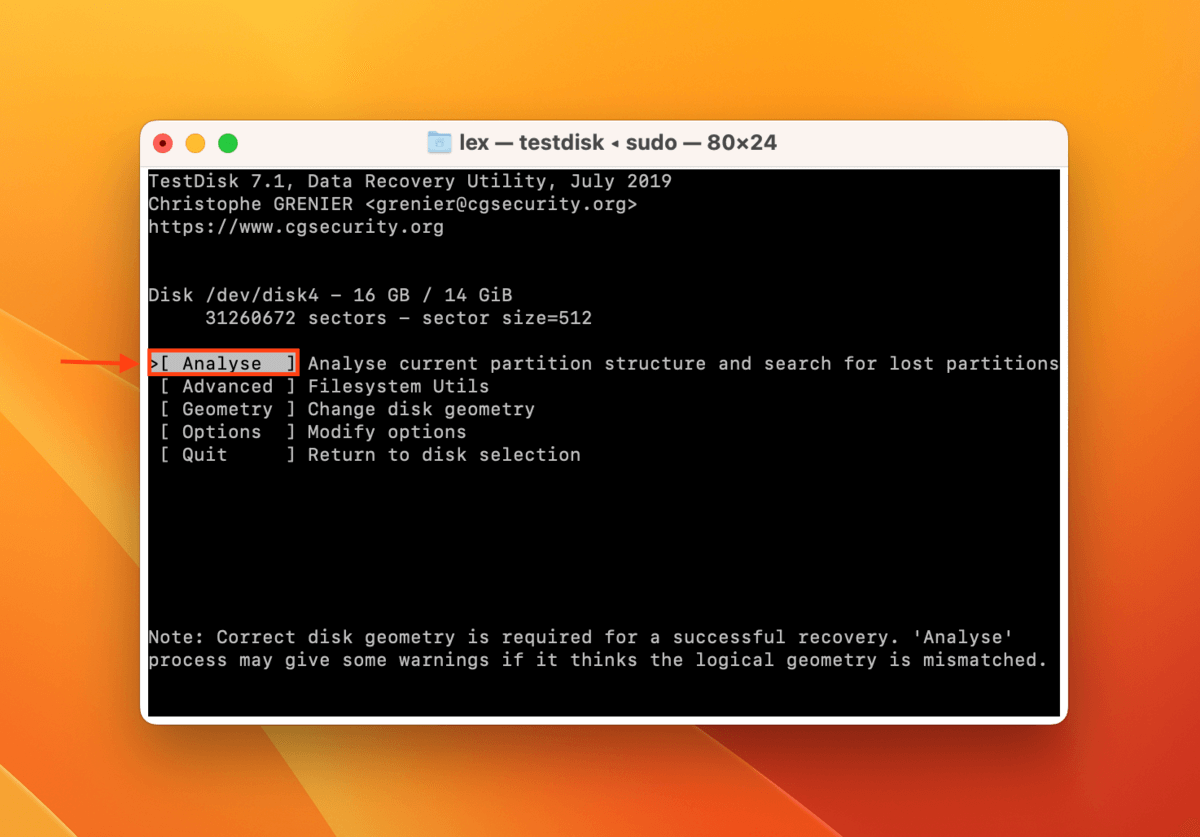

Step 7. Hit Return again to select the Analyse option.
TestDisk drive actions

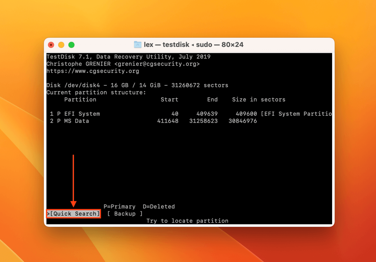

Step 8. Hit Return once more to select the Quick Search option.
TestDisk Quick Search option
