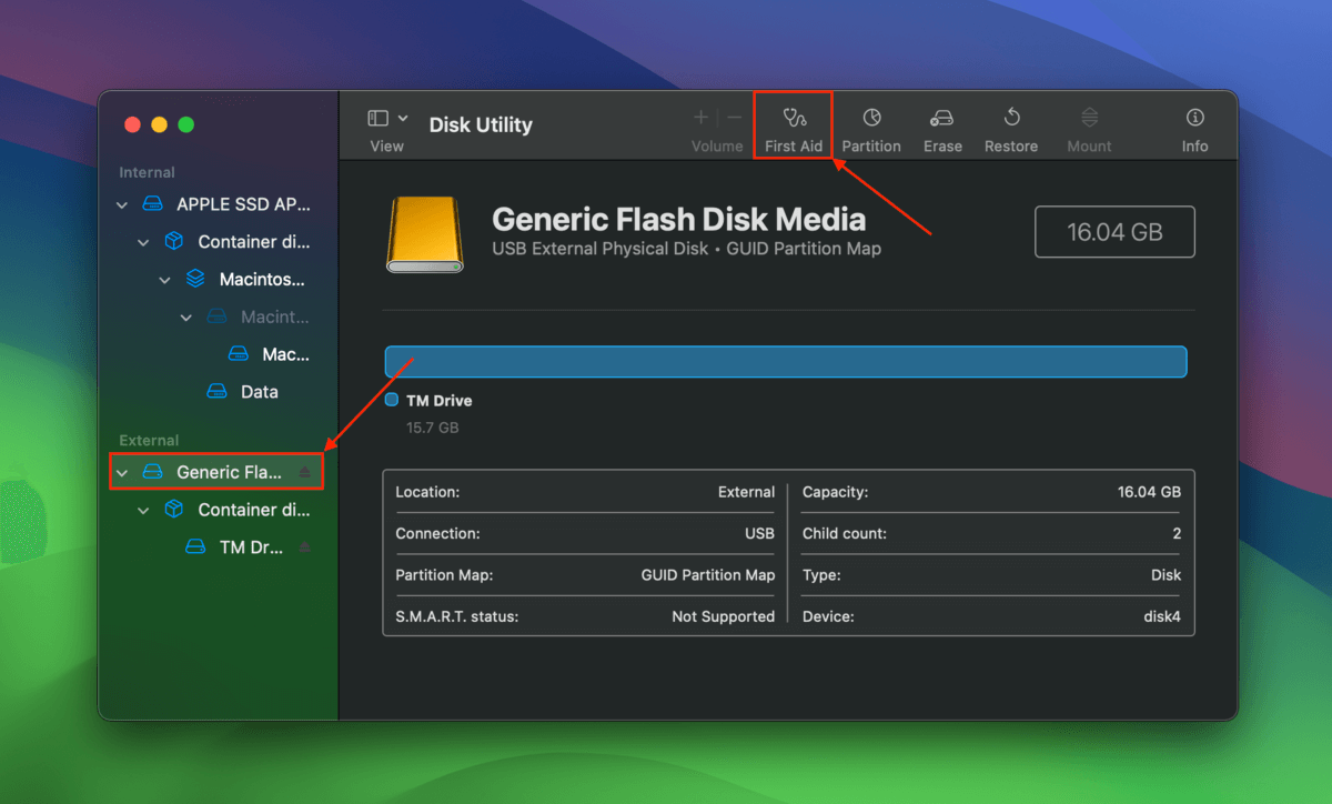

Method 1: Run First Aid on Your Time Machine Drive
First Aid is a Disk Utility feature that can automatically detect and repair simple disk errors. It’s not powerful enough to fix everything, but it can solve many logical errors related to the drive’s file system that could likely be preventing Time Machine from operating properly.
Step 1. Connect your Time Machine backup drive to your Mac.
Step 2. Open Disk Utility (Finder > Applications > Utilities).
Step 3. Select your Time Machine drive (not volume) from the left sidebar, then click the First Aid button.
First Aid tool in Time Machine
Step 4. Click Run when prompted to confirm the operation.
Disk Utility Fist Aid confirmation dialogue
If First Aid is unable to repair your backup Time Machine drive, you have to format it. See the next section for details.

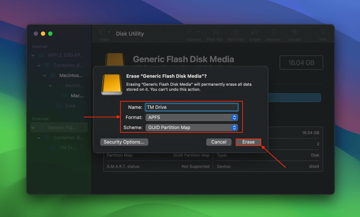

Method 2: Reformat Your Time Machine Drive
MacOS can only work with Time Machine drives using the same file system format – in fact, Time Machine sets up your drive this way by default.
It’s possible that you created the backup while your Mac was using another file system, and then changed it down the line.
This was a common issue for users upgrading from Catalina to High Sierra, which replaced the default macOS file system format from HFS+ to APFS.
To get your Time Machine drive to work with macOS, you need to format it to the correct file system. Time Machine will do this automatically for you, but we prefer using Disk Utility’s Erase tool at least for the first time you’re setting up your backup again.
This process will absolutely wipe any data on the drive – see this section before you proceed.

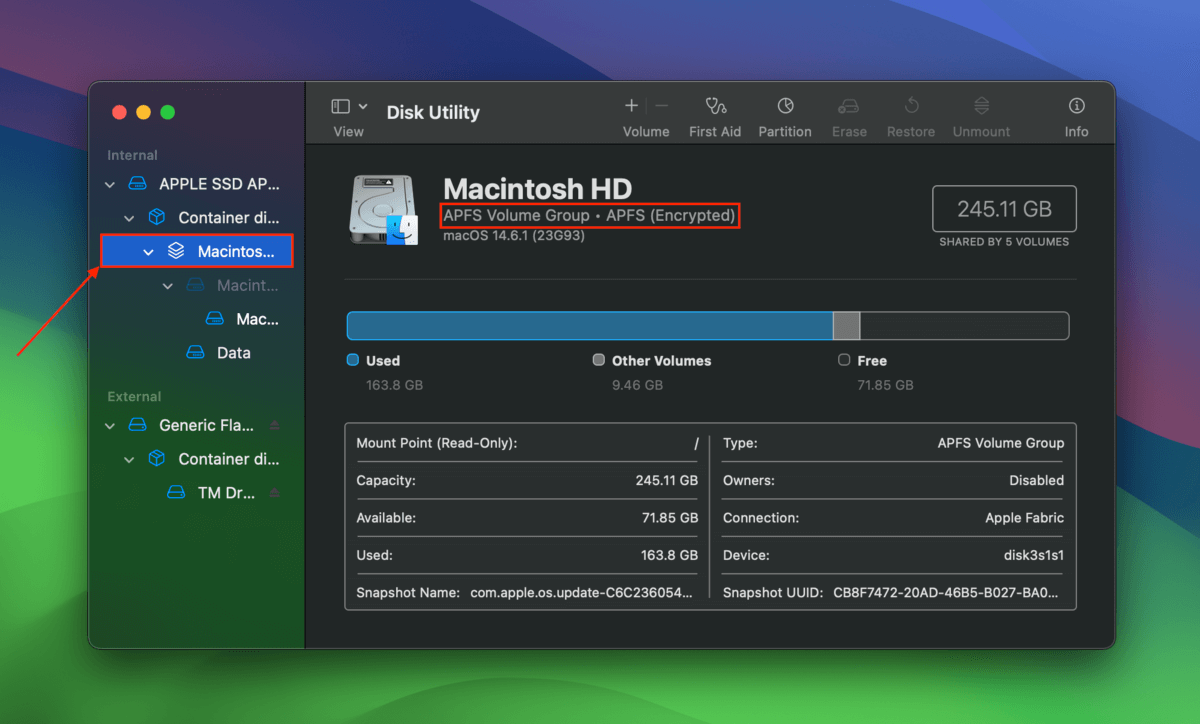

Step 3. On the left sidebar, expand your Mac’s system drive and click Macintosh HD. Check which file system your computer is currently using.
Macintosh HD information in Disk Utility
Step 4. On the left sidebar, click your Time Machine drive (not volume). Then, click Erase.
Disk Drill Erase tool on Time Machine drive
Step 5. Name your drive. Then, set its Format to whatever file system you noted in step 3 and its Scheme to GUID Partition Map. Finally, click Erase to confirm the action.
Erase tool dialogue menu in Disk Utility

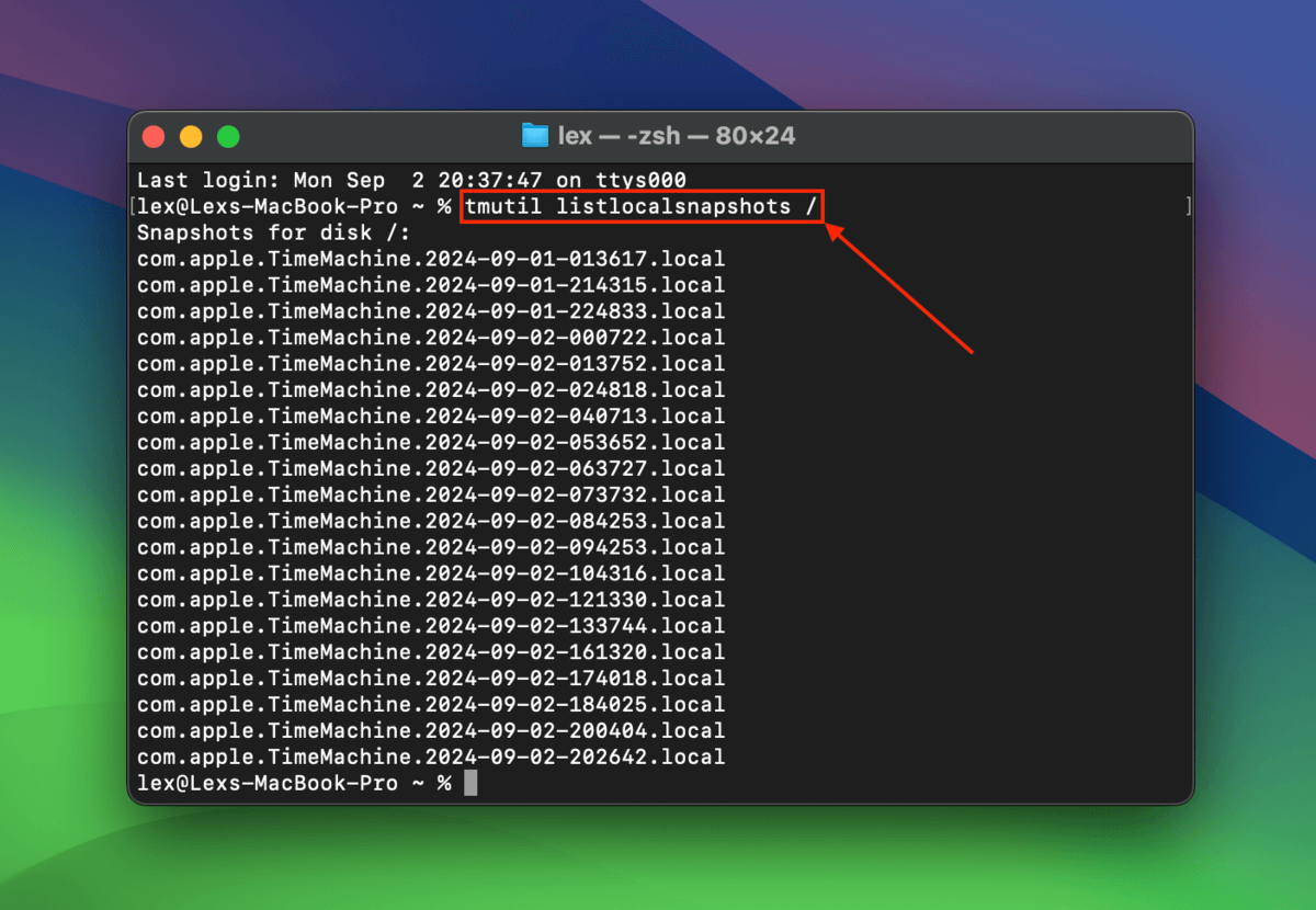

Method 3: Delete Local Time Machine Snapshots
When you enable Time Machine and set up your backup drive, it continues to take “local” snapshots of your data even when your drive isn’t connected. Unfortunately, they can be corrupted and improperly indexed, leading to issues with Time Machine’s functionality.
Deleting these local snapshots may also eliminate the conflict they are causing with Time Machine. You can delete them with just a few lines of Terminal commands.
Step 1. Open the Terminal app (Finder > Applications > Utilities).
Step 2. Start with the command that lists down all the local Time Machine snapshots on your machine:
tmutil listlocalsnapshots /
List local snapshots in Terminal
Step 3. Next, execute this command to delete a local snapshot:
sudo tmutil deletelocalsnapshots 2024-08-30-185712
Replace the last chunk of the command with your own snapshot’s date and code.
Delete local snapshots Terminal command
Step 4. Keep deleting local Time Machine snapshots one by one until you find the snapshot responsible for the error.
User “Martin” from the StackExchange forum posted a script that automatically lists and deletes all local Time Machine snapshots on your machine. This is useful if you have hundreds of snapshots and/or you don’t really care about keeping local snapshots. Simply paste and execute this code in the Terminal app: for d in $(tmutil listlocalsnapshotdates | grep “-“); do sudo tmutil deletelocalsnapshots $d; done
