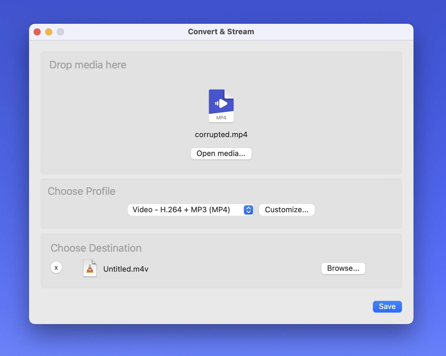

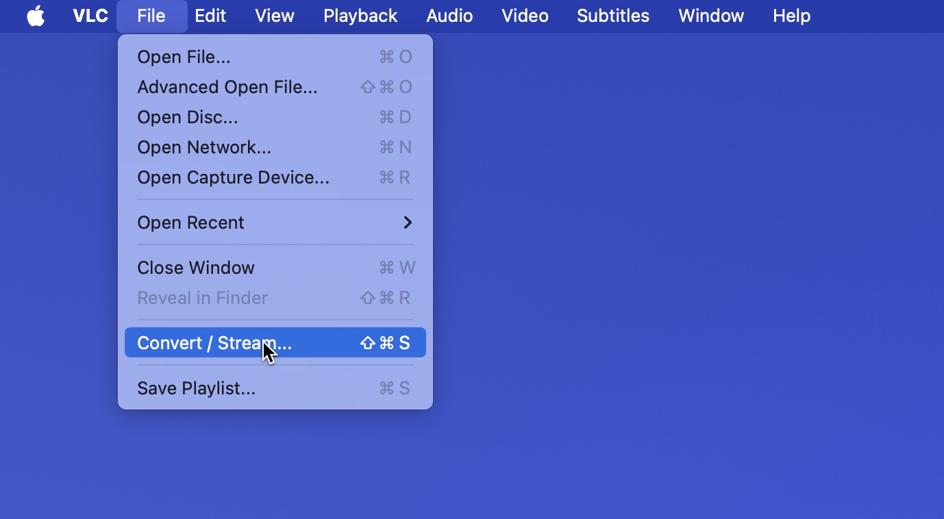

If you’re still unable to play corrupted video files, VLC offers a conversion feature that can help you recover corrupted video files:
  1. Download and install VLC on your system (only desktop versions of the media player support the conversion feature).
  2. Open VLC and click on File in the top menu, then select Convert/Stream.convert stream vlc
  3. Add your corrupted video file.
  4. Choose a video profile (the default one is a good starting point).
  5. Specify the destination where you want to save the new file.vlc video conversion mac
  6. Click Save to begin the conversion process.
VLC will essentially create a new copy of your video, which can often fix issues with the original container or metadata.
